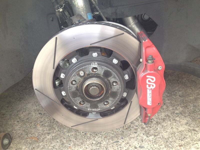

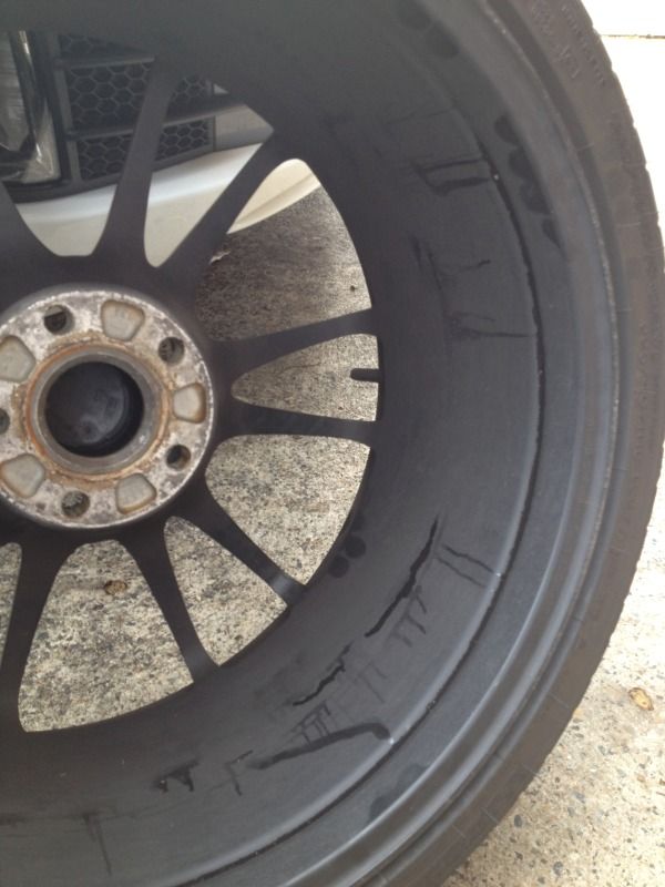

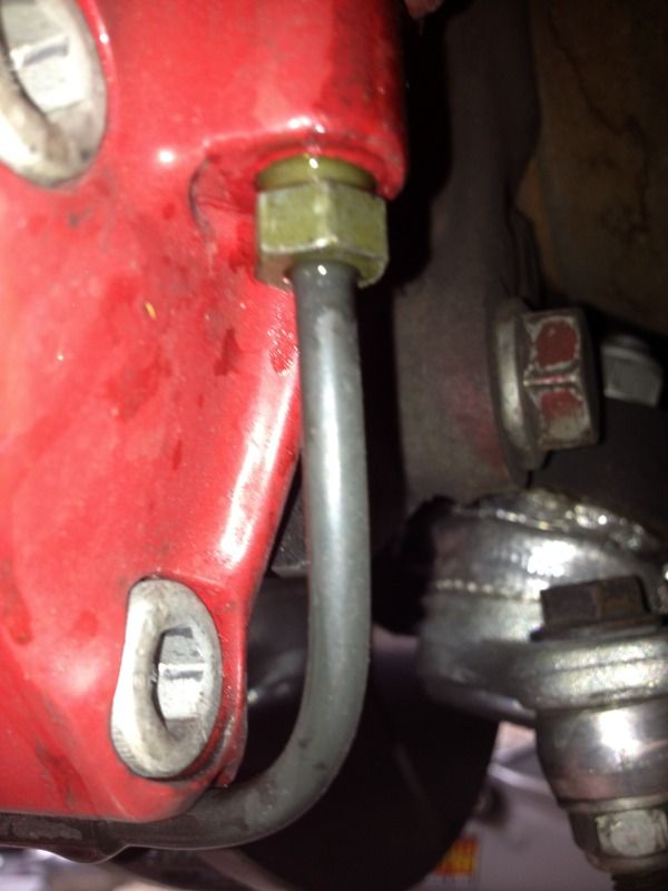

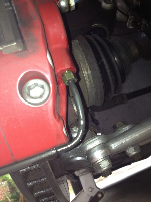

So after 6 weeks installed on my car, and 2000kms of street only use my drivers side caliper has failed and started leaking fluid.
They were not modified, or repaired prior to being installed by a professional mechanic.
Photobucket
Photobucket
Photobucket
Photobucket

have you tried tightening the crossover line, I had to tighten one of mine up after the install. It's good practice to keep an eye on them during break-in, just spray them with some brake cleaner after you tighten them so you can see if any fluid has leaked. This is common practice from what I've seen online.

Has anyone bothered to take off this tube completely in-between brake bleeds to check on the flange the nut rest against and which seals inside the caliper? It should be a double flange and not single. It should also show no signs of cracking along the flange at all. If it's cracked then it has to be replaced. If it's not double flanged, which reduces the tendency for cracking, then it should be replaced with one that is. I believe if you take a look at all hard lines on cars today that the flange on the hard line is double flanged and is a requirement for DOT and other manufacturing specs. for other countries because it is a superior method for a reliable, and safe method of connecting a hard line to other brake parts. This may be hard to see given the equipment to do this is quite good in covering up the double flange appearance. I'll have to research a web-site link to show this more clearly, but I believe you may be able to find it in an Earl's catalog. If I'm wrong on this I also report back and let you know.
Al
