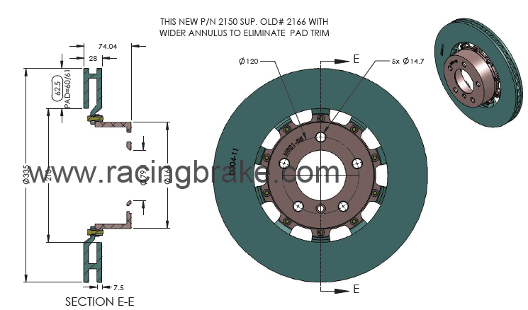

    Front P/N: 2150
    The front disc is a newly designed with wider annulus to cover the OE pad w/o having to trim the pad bottom like the old design.
    Since it's specific for this application only so we need at least five 135i owners commit to the pre-orders in order to make them available

      Front two piece rotor with new disc is assembled and checked.
      The new disc (335x28 vs. OE 338x26) annulus is confirmed can fit OE pad without trimming at bottom, no overhang on the top.
      Approved for shipment release.
