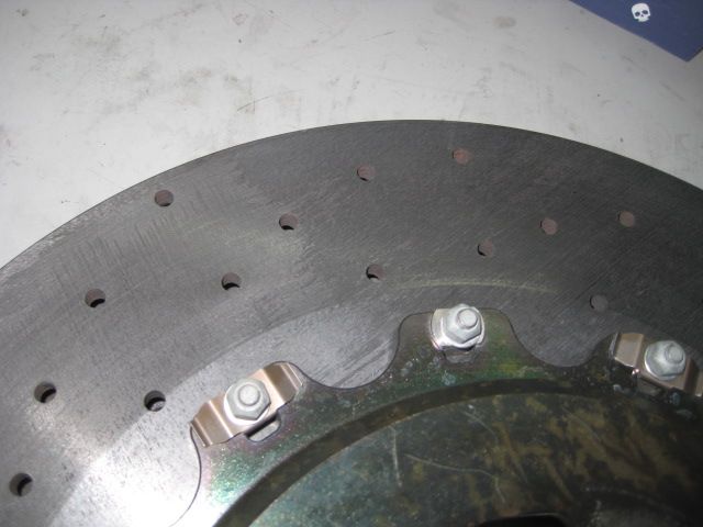

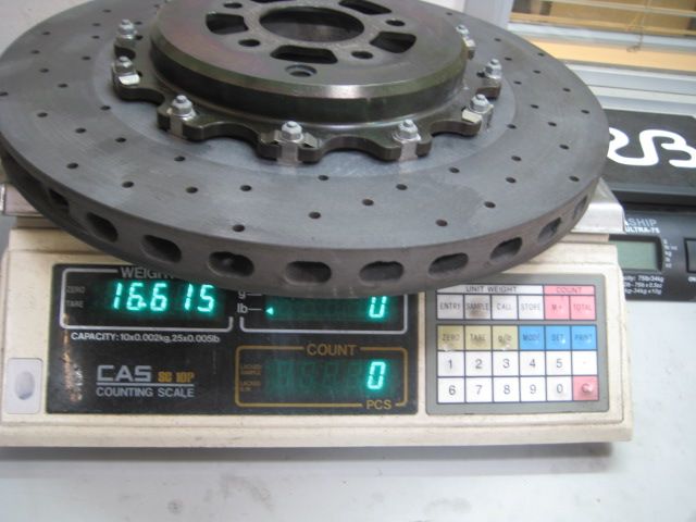

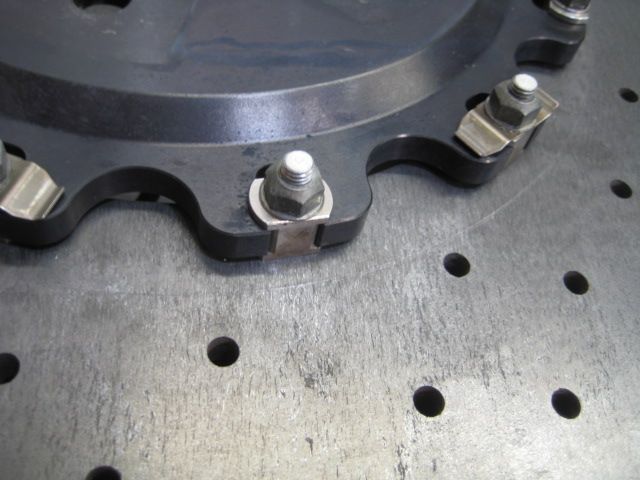

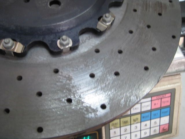

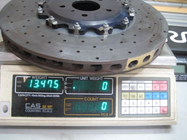

    CCM rotors before refurbishing - Typical rotor surface condition:
    Rotor edge (left) showing some de-lamination:

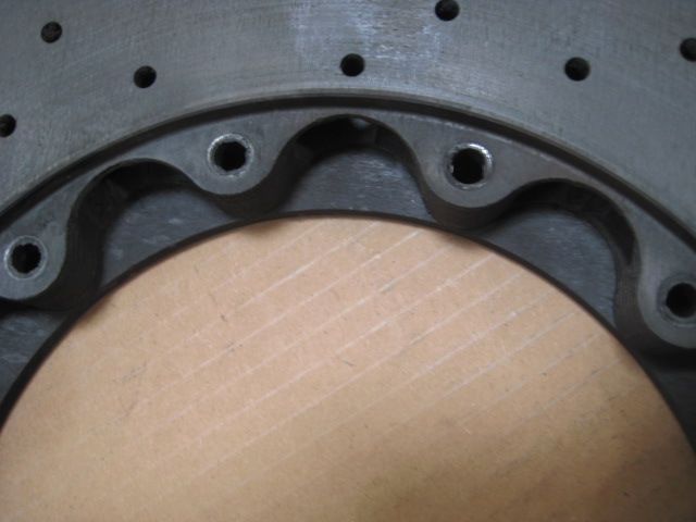

    Mounting hole damaged from over-torquing in original assembly:
    Front rotor:
    Rear rotor (w/iron hat for e-brake)

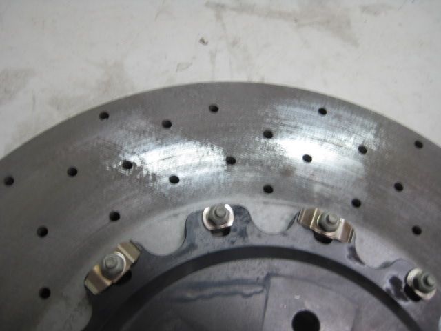

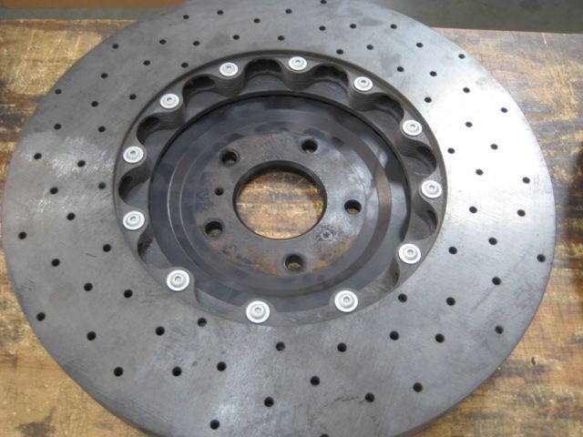

      CCM Rotor after re-furbishing:
      Assembled with original hardware:
      Damaged mounting hole replaced with RB new hardware:

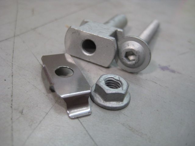

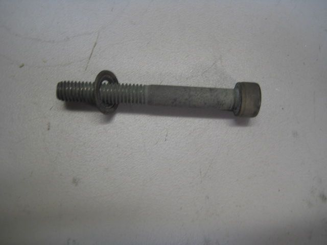

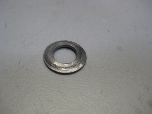

      Original AP hardware and "coned" flat washer:
      RB specially tooled hardware with wide and never "coned" flange bolt with Allen hex for easy assembly, low profile self-locking hex nut to provide positive and consistent torque at any temperature. Hardware are heat treated and dacrotized for corrosion resistant.
